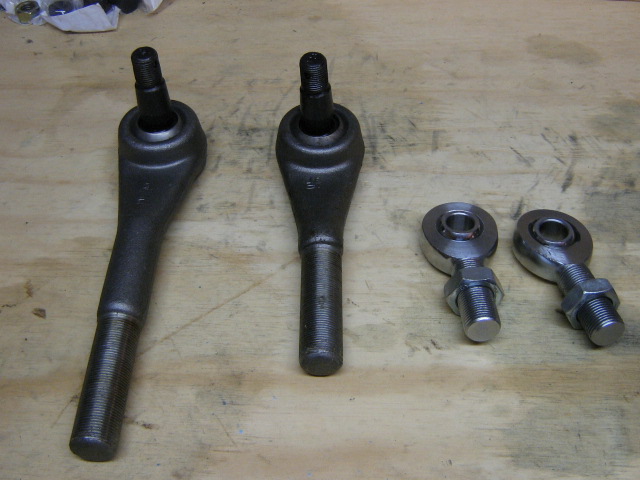

What would be wrong with running a drag link with Chevy TREs and a tie rod with heims?
I sent off my pass knuckle to ORU ato hav ethe crossover arm put on and I just foudn out that the hole that is on the arm for the d-link is tapered for a 1 ton Chevy TRE. My fault.
Also, 1 ton Chevy TREs are always refered to as 7/8".......is 7/8" the thread size? or the bigend of the taper??

Also, ORU thought I was crazy for wanting to run heims joints in any rig that wasn't a "full blown race truck".......Whats up with that???

Thread size... 7/8 - 18Originally Posted by JBrown89

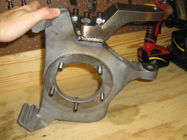

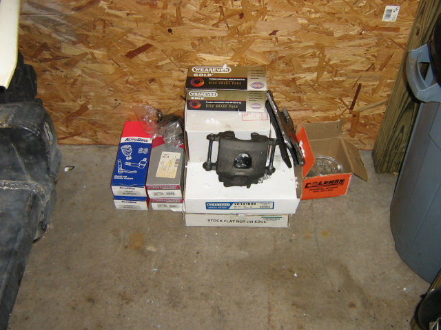

bought 4 Chevy TREs today. They really make the heims that I wanted to run look small. Also, the UPS guy brought me a new passenger side knuckle for the D60 so I can run crossover.. The first picture is of all the parts piling up (all the rear disc brake conversion stuff)
