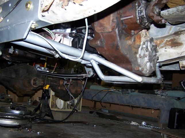

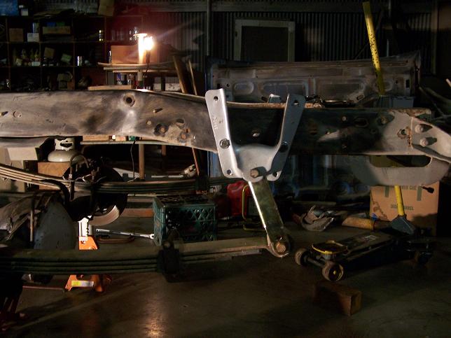

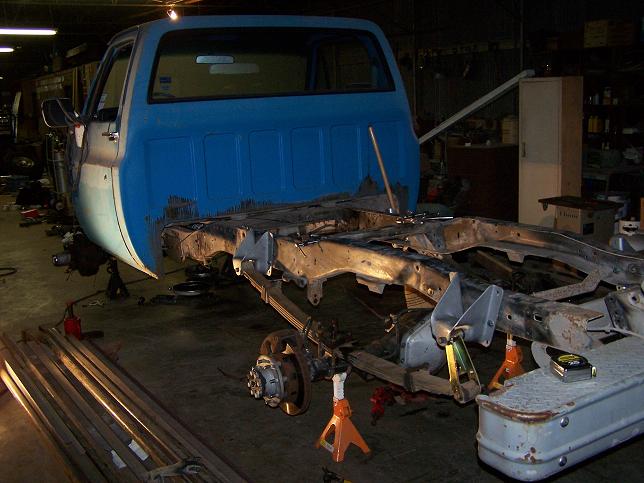

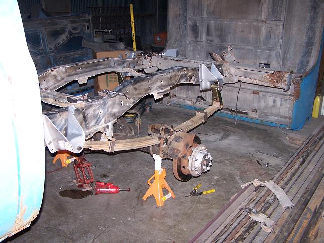

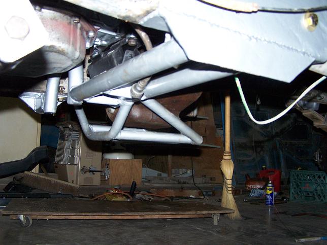

No, I wont be running the bed. I positioned the rear axle so that I would not have to modify my High Angle CV driveshaft from the suburban (58" long). If it really bug the hell out of me, I might go changin it up later, but we'll see. The rear axle is about 1' forward of "stock" position on the frame. That coupled with the front axle moved forward 4" should make for about a burban sized wheelbase. (~130") I know this is long but I plan on running the biggest tires I can afford later so who knows what could happen.
