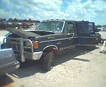

second report, bronco steers like a huge pile of doody, cant go over 35 on the speedo without changing lanes rapidly from side to side with no control. i then slowly drove it to a reputable front end and lift shop where me and the owner examined it and it seems that i have way to much of an angle and lift past what the 7 degree bushing in the radius arm fixed, so i now have to get my arms built pronto when i get back to college station, and i also have to lengthen the existing trac bar, or build a adjustable bar, i believe this has to do with the extreme case of death wobble.
but on a good note i took it to my friends house(slowly) and drove it and flexed it on lots of old telephone poles and chit and everything worked good. cant wait to get back to c.s. this friday with or without the bronco in tow. if i dont bring it with me it will be brought the next week.
and i think i am going to raise my coil towers like and inch to get this ho level instead of putting more lift in the rear.
