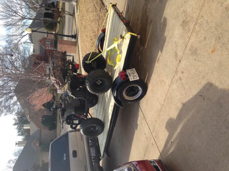

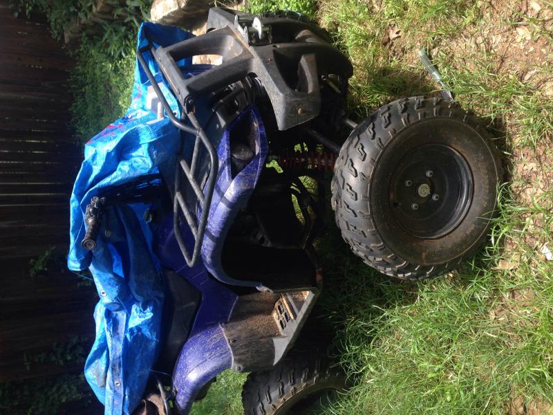

    ok so i don't know what the brand or make of this 4-wheeler is but my dad bought it a while back and had it painted blue and re-geared to tow and pull. well the chain keeps coming off and it happens alot. anyone having any ideas what the problem is? or just a simple warn out part we are over looking? I'm trying to get it fixed before the beach trip in 2 weeks so i can take it out

    If the chain is falling off, either it is to loose or out of align.

    Or the sprockets are worn out. Looks like a chinese reverse engineered yamaha knockoff.
    When the chain comes off, how do you put it back on? Do you have pictures of the sprocket?

    usaully the back axle is out of alignment or the back axle is bent. there are two adjustmet bolts and the bottom of the back axle(and two others that mush be loosened first) to adjust. you can get a rear axle on ebay.
