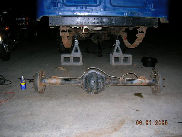

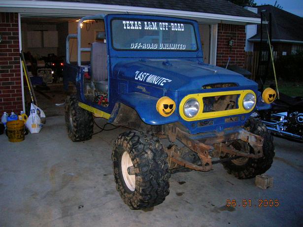

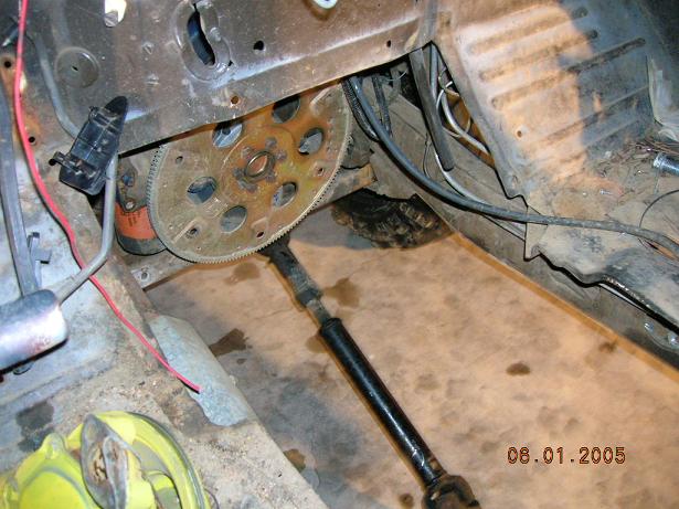

So on with the progress. Here it is as pulled out of the garage. It's gotten a little dusty. First order of business was to remove the fenders. The passenger side got pretty crunched at TCC a couple years ago.
http://img521.imageshack.us/img521/9940/dscn1148xs5.jpg
http://img509.imageshack.us/img509/2938/dscn1150ra0.jpg
One fender!...Aaah, Aaah, Aaaaah!
http://img474.imageshack.us/img474/1581/dscn1151wv1.jpg
Two fender!...Aaah, Aaah, Aaaaah!
http://img375.imageshack.us/img375/6055/dscn1152ax5.jpg
