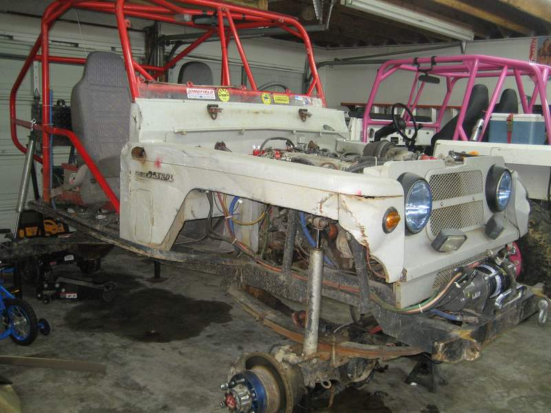

The Patrol (Phase II before I took it apart)
Attachment 18967

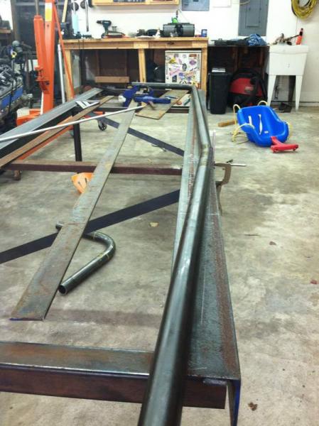

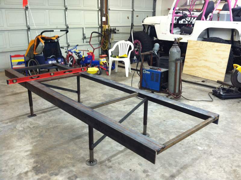

Built a Table to work off of:
Attachment 18966

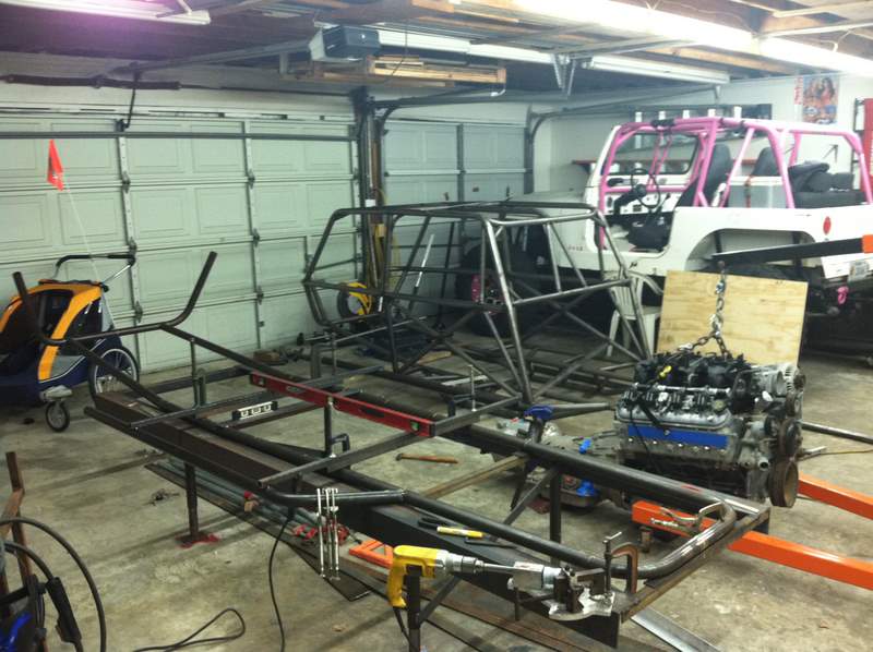

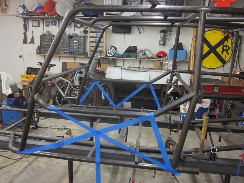

This is where I got after one day and one night on the chassis.
Attachment 18964

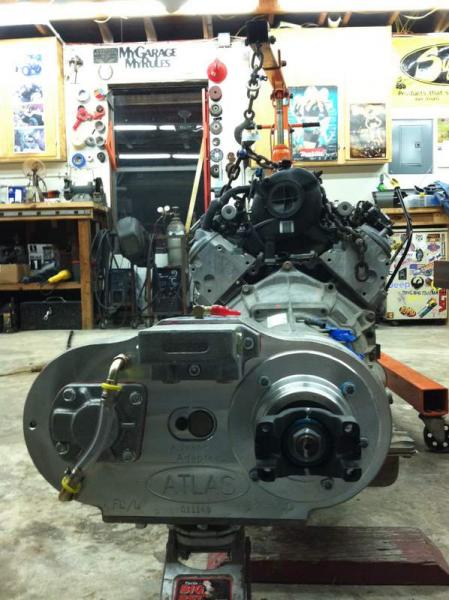

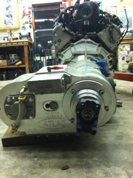

The t-case dropped down a few degrees
Attachment 18965

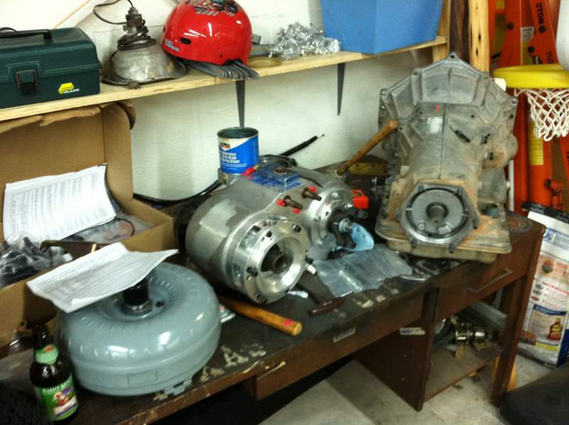

I changed the T-case back up to 0 degrees for a better two piece driveshaft angle at the bearing
Attachment 18968
