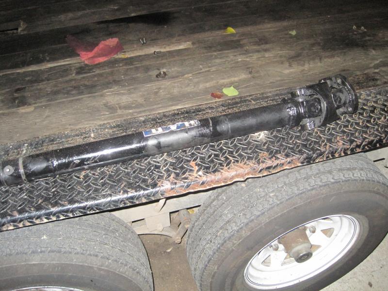

rebuilt my front driveshaft, now i just need the flanges back from the machine shop
Attachment 18991
