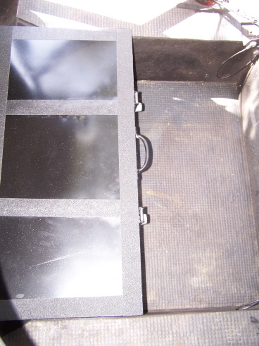

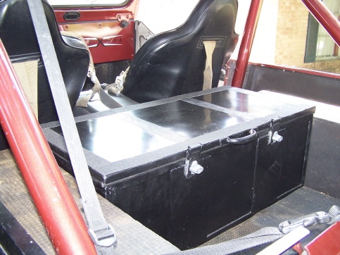

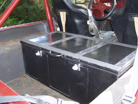

i finally finished the box for the bed of the jeep, the frame of the box is built from 3/4x3/4/3/16" angle, the lid is 3/4x16 gauge box, and its covered with 20 gauge. Its got two locks and gasket material to keep it waterproof as well as being caulked to hell because the last thing i want is this thing leaking.

was that cheaper than buying an aluminum box? I know it wasnt easier or lighter. It does fit nice though.
i don't know how expensive an auminum box would have been, i looked around for one, though i can't say for very long or very hard, but to my credit i did look. It cost $100 give or take, it's always the little expenses that jump up and bite you in the ass, the metal was around $80 which i thought was pretty resonable, but then hardware, paint, caulk, tape and gasket is what really surprised me, it was probobly closer to $150 now that i think it out.
oh and its not rediculously heavy, about 30 pounds.
is there a reason that you didn't make it flush witht he wheel wells
yah the tallest item i carrry around with me are those large jugs of engine oil and coolant so the box was made with a 1/2" clearance of these items.
