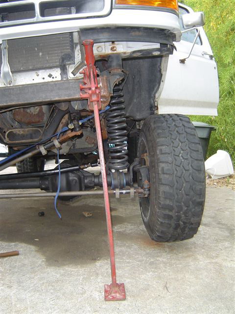

This kind of goes along with the whole "Guns don't kill people, stupid people with guns kill people" thing. A hi-lift can be a very valueable tool when used properly and with plenty of precausions and forethought. In all seriousness, if you get the two front wheels in the air with even one hi-lift, be very careful, that is an accident waiting to happen. My grandpa set up a few demonstrations when I was about 10 or 11 so I could see just how dangerous they were.

at least get some logs or something under the frame so it doesn't keel you Seth. That would suck. You can borrow my hilift if you still need one

Seth to get the trac bar aligned you are supposed to, have someone inside the truck and have them turn the wheels while they are on the ground, this will make the body move to one side of the other, so that you can get it alignined, you will prolly need to do the two ratchet straps as i mentioned to you earlier since yours is quite a bit out of whack, then resort to the turning of the wheels.

Did some more dangerous jacking this evening. Got a couple more little things figured out. The only way that axle is moving is by jacking the frame high enough that the wheels hang free, or with the steering method. I want to get it close to where it is going to be, then I can see where I want to put the trac bar mount. Also I will be able to tell if I am going to have to trim the crossmember or not. As the axle centers under the truck, the truck is going to lift up a little. I would rather not try to use a come along or ratchet straps to accomplish that - straps will be used to hold it in place once its there. It is hard to type it all out on here, one of those things where seeing it and talking are alot easier.

Got some more done tonight. Filed some threads. Got the brake lines off. Got the axle a little more in place, and strapped in that place. got rid of a wasps nest in the door jam (first one) gotta decide which way to flip the trac bar - anyone actually have any experience with this app? I am gonna post it up in FSB, and see what I can sift from that as well. pics in a sec.

I can mount the bracket I have horizantally or vertically. I feel like vertically will be stronger and cleaner, I just have to figure out how I want to secure it. I am leaning towards bolting it right now. I don't have a welder for one, and also I can change it later if it doesn't work how I like or I change anything (like the spring buckets or radius arms and wheelbase) Any ideas? It is kinda hard to photograph and even harder to explain. Basically I need to bolt this bracket to the inside side of my C channel frame. So I need to somehow bring a flat surface all the way out to bolt to. I think I piece of 2x4 tube could do this, then drill through both sides of the tube and the frame (and the spring bucket) and run bolts through all of it. This also put the eye of the bracket right where I need it to locate the axle and still have some adjustment. I have some nice angle that I will most like run from the bolt and back to the crossmember and bolt it there as extra support.

post number 22 look at the design, this is what you neeed to do since it is all bolt on for the most part except for welding of the pieces of the bracket which can be done elsewhere. then after that you can have all the pieces welded to the frame if you so desire.
that looks like it is sturdy enough
seriously? 2 little bolts under a whole lot of shear force? Also considering what we know about that frame so far I would stop no shorter than the bracket posted near the bottom of that page. It's not that hard to get a hold of a welder...you can even rent a 120 mig at Home Depot and weld it up well enough to drive it to a big welder
edit: I looked again and noticed there's a brace from there to the center of the crossmember...if that's solid it's probably okay

So I went out and stared a little more today, this time with a couple pieces that I could check for fit. I also brought a bunch of scrap steel pieces I had in Irving home with me, so now I have enough nice heavy angle iron to build just about anything I can dream up I guess. My original idea is not gonna work. The thing that kinda bugs me is that there is more than one way to do it, and I want to make sure I go with the best one.

the main thing is it needs to be bolt on for him to use it for the time being or until he can take it somewhere to get welded, unless he welds it with a 110 mig that he rents from home depot like eric said.

no offense, but this track bar mount thing is turning into a monkey ****ing a football situation. all this scratching your ass and slaping your dicks doesn't do anything if you don't go out there and start building something to get a general idea. just make sure what you make is going to work before you start drilling holes or welding some shat pile on the frame
this is all stock stuff for 76-79
